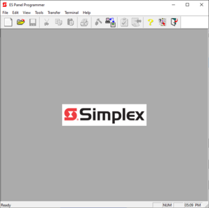

Simplex ES Panel Programmer Version 6.04.02 Main Screen

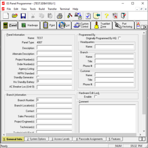

Simplex ES Panel Programmer Version 6.04.02 Panel View
The Simplex ES Panel programmer is Windows-based (supported on XP and later) proprietary software that allows a technician to program Simplex ES-series panels such as the 4007ES, 4010ES, 4100ES, and some additional equipment like a Network System Integrator (NSI).
The ES Panel Programmer requires a valid license to program 4010ES or 4100ES panels. Activation of the license can be done through an online activation system, or locally using a file-based license. Programming dongles are not supported on the ES Panel Programmer after version 4. In version 6.03.01, licensing was changed to a system which more heavily favors online activation.
"Job Files" are the term used for the panel's main configuration file. They are a variation of a Standard Jet Database and use the file extension .SDB4100U.
